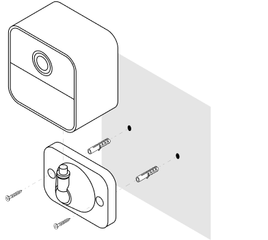

The camera can be placed on a stable horizontal surface, or it can be mounted on a wall. If you mount the camera on a wall, there are three methods of doing so:
  • Mount the camera magnetically to the mounting plate that is attached to the wall using the supplied adhesive patch. Use the adhesive patch only on smooth, clean and grease-free surfaces. This method allows for quick and easy removal of the camera when it needs to be charged.
  • Mount the camera magnetically to the mounting plate that is screwed to a wall using one of the supplied masonry plugs and screws. This method allows for quick and easy removal of the camera when it needs to be charged.
  • Screw the camera directly to the wall using two of the supplied masonry plugs and screws. Only choose this option if the camera is always powered by the USB-A to USB-C charging cable.
