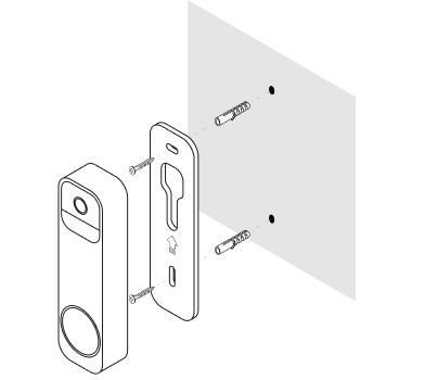

Placing/mounting the Video Doorbell
Find a suitable place to install the Video Doorbell. Preferably, this is the place where the current doorbell is installed. Please keep the following in mind:
  • Always ensure that the Video Doorbell is aimed exclusively at your own property. The Video Doorbell should never be aimed at public space.
  • Ensure that the camera lens is never exposed to direct sunlight, as this can negatively impact image quality.
  • The Video Doorbell is weather-resistant (IP66). To prevent excessive exposure to wind, rain, and snow, when possible install the device in a covered area. This also helps prevent raindrops on the lens from making the footage unusable.
  • If you replace the button of your current doorbell with the Video Doorbell, check if the doorbell transformer in your meter box has a voltage between 8V and 24V AC. Then remove the old doorbell and slide the two wires of the existing wiring each into a separate hole of the supplied loose plug at the extension cable. Now squeeze the transparent end with pliers. The wires are now connected to the copper connections in the plug.
  • If you want to rotate the Video Doorbell horizontally or vertically, first mount the vertical or horizontal wedge with the opening of the wedge over the hole where the wires come out. Attach the mounting plate to the wedge using the supplied small screws.
  • Connect the extension cable to the plug connected to the old doorbell wires. Then connect the U-shaped connection points on the other side of the extension cable to the connection points on the back of the doorbell. Slightly bend the U-shaped connection points towards each other to form a V-shape.
Attach the Video Doorbell to the mounting plate with a sliding motion downwards. The Video Doorbell will now click into place on the mounting plate.
If you want to remove the Video Doorbell from the mounting plate again, keep in mind that the Video Doorbell is now anchored to prevent theft. To release the anchoring, insert a small flat screwdriver exactly in the middle at the bottom between the Video Doorbell and the mounting plate. At the same time, carefully slide the Video Doorbell upwards.
